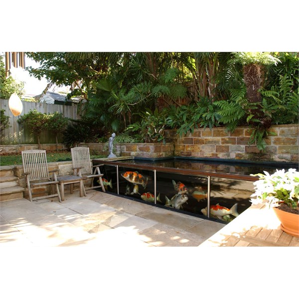

By the way, that backyard pond next to your signature looks like a nice one.
