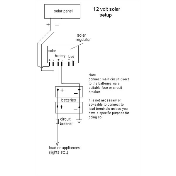

Follow Up By: Member - Bruce C (NSW) - Saturday, Sep 21, 2013 at 13:47
Mark here is a simple diagram I have made to outline the circuit for you.
Note that you should keep the cables between the regulator and batteries as short as possible and about 6mm at the very lightest, heavier is better. The length of cable from the panels to the regulator can be 6mm as well. This can be purchased from ABR Sidewinder who is a business member on this site and a very good mob to deal with as many here can attest. He is another preferred supplier for this reason.
Diagram
FollowupID: 798420
Follow Up By: Member - Bruce C (NSW) - Saturday, Sep 21, 2013 at 13:52
I'll try again.
Sorry for that but I tried to upload in the wrong file format.
try this one
FollowupID: 798421

WOW that is fantasic info and a diagarm as well thank you for taking such time to help its great ! Regards Mark

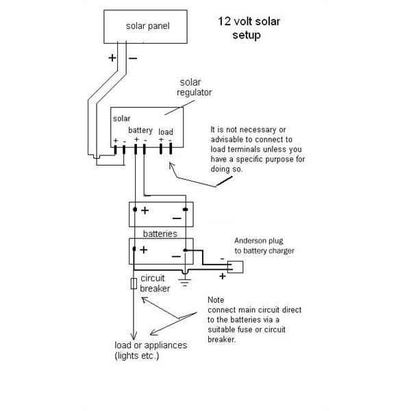

Bruce Sorry to be a pest but how would I or could I configure that diagram with say a 2 or 3 kva sinewave generator .
Regards Mark
FollowupID: 798535
Follow Up By: Member - Bruce C (NSW) - Monday, Sep 23, 2013 at 14:51
I assume you wish to charge the batteries and use the 12 volt power at the same time.
To this end I would get a 25 amp CTEK or a similar PROJECTA battery charger and run that off the generator to charge the batteries. These bigger chargers can be used as a power supply as well so there is no problem using them as described.
I would use a modern 12 volt compressor frig such as this one
12 volt compressor Fridge
or this one
bigger 12 volt frig
I will include the previous drawing with a modified circuit to plug in a battery charger.
Hope this helps,
Cheers, Bruce.
FollowupID: 798546

You won't need a genny as big as 2 or 3 Kva to run the battery charger. Also make sure you use heavy wiring to avoid voltage drops & I used 415 volt connectors as they minimise voltage drop also.
If you have not got a GOOD quality terminal crimper get someone to make up the cables for you.
