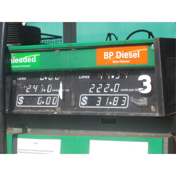

Reply By: aboutfivebucks (Pilbara) - Thursday, Nov 21, 2013 at 21:28
Sometimes I feel for petrol users in remote locations.
They seem to pay a little more than diesel.
