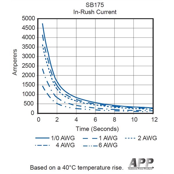

Please forgive me for opening yet another "Anderson plug" topic but I did a search but couldn't find the info I'm after, yet.
Has anyone made up a set of vehicle jumper leads with Anderson Plugs on one end for plugging in to similar plugs connected to the aux battery to jump start a dead vehicle? I know that the aux battery needs to be of a suitable type but what I'd like to know is whether the 175A plugs are suitable or should it have the 350A version. Getting the parts and crimping/soldering isn't the problem.

Reply By: ABR - SIDEWINDER - Thursday, Feb 06, 2014 at 18:02
Hi Phil
175A plugs are fine. Here is a current graph that will help you.
Derek from ABR
