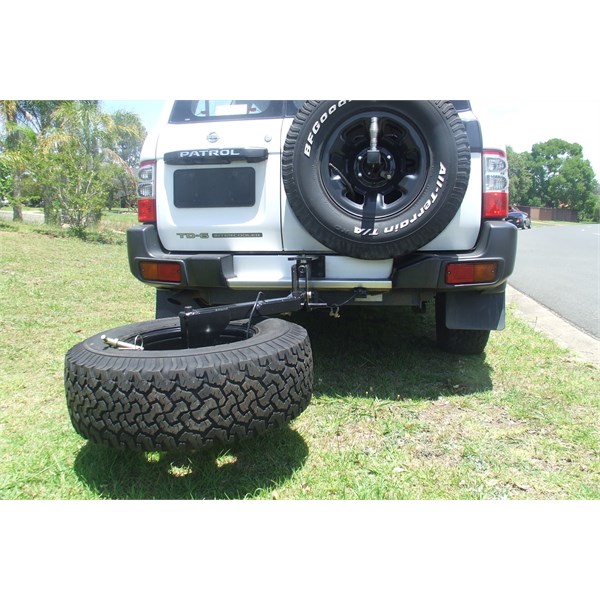

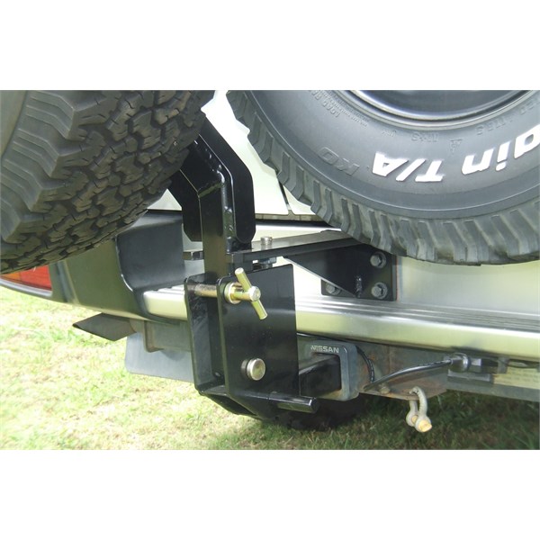

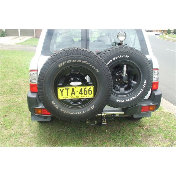

The Kaymar bar will give you a spare wheel and a jerry can or two wheels or two Jerries! I think the Kaymar bar is one of the more expensive bars and in my opinion all that extra weight and cost is hard to justify just to carry one extra wheel. You could get a roof basket and carry two Jerries and a spare tyre, no rim as mentioned. 50kg for the full jerries and 20 kg for a tyre, no rim. This is what I made to fix the second wheel problem but doesn't deal with the extra fuel.
AnswerID: 526229
Follow Up By: Michael ( Moss Vale NSW) - Tuesday, Feb 11, 2014 at 21:10
And the good thing about this wheel holder is that when you get home, take it off! Michael

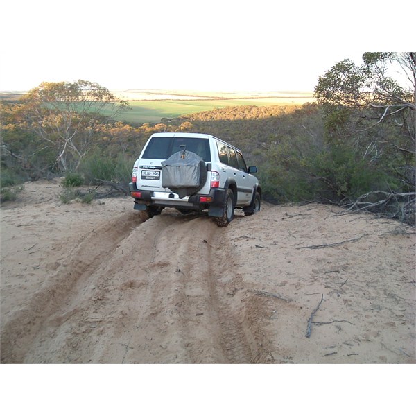

So on the fuel I made up a special bag that holds two empty plastic jerries.
I prefer to carry fuel inside the car , even if its a squeeze , and at end of first day the jerries are empty and go into Bag on back of our Patrol.
Also dumped the normal towbar and made a lightweight unit which saved a nett 16kg
