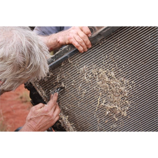

Recently I was under my sons Hilux which has a fancy looking bullbar fitted, the plastic screen was missing from under the radiator and I realised that the bottom tank of the radiator was about 50mm lower than the bottom of the bullbar.
So if he were to run over a stump or a rock the bottom tank would most likely be damaged, the bullbar does not protect the most fragile and essential part of the vehicle.
I checked my Troopy which has a top brandname bullbar fitted and it is the same, I have since added some substantial structure to protect the radiator, the plastic guard won't stop much.
Just wondering if anybody else has noticed this on thier Toyota.

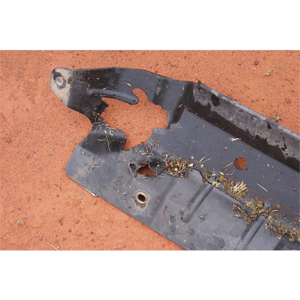

Yes and I bought a purpose built guard from Brown Davis to alleviate the issue. Unfortunately we've had first hand experience at how little the plastic guard will stop!
Cheers Mick

TJM, ARB etc make protection plates to suit
I had them on my Hilux and my Cruiser

Our ARB Commercial bar came with one. I think that it was an actual part of the bar and not an accessory or add-on. Looks like a bit of powder coated checker plate.

When I baught My 4wd diesel hilux the bull bar that came on it was exactly the same.
It provided no protection for the borron 120mm of the radiator......it had not been punctured but that whole section had been pumbled by small stones.
The two bars I have had subsiquetly have not had this issue.
NOW I have fitted that same alloy bullbar to my petrol 2wd hilux...bolts straight up.
The radiator in this vehicle is not exposed in that manner.
The diesel radiator is much bigger and deeper than the petrol one.
