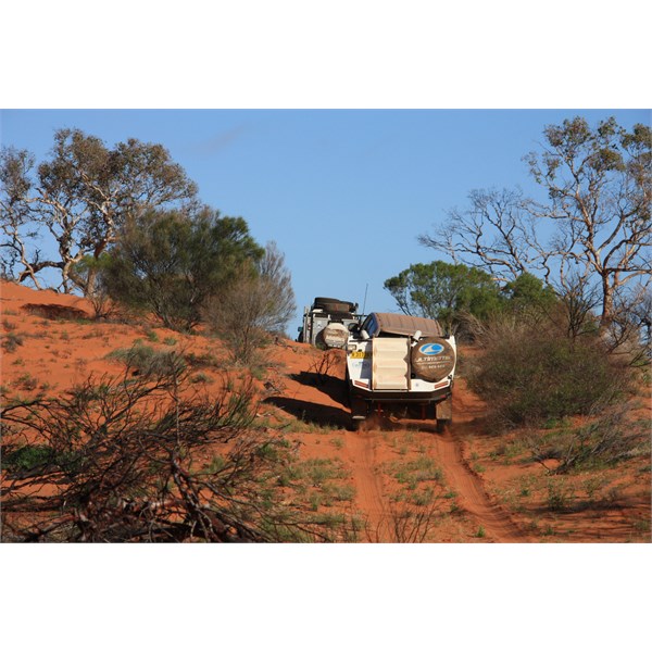

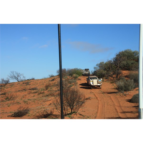

Trecker, we recently convinced my father to upgrade the
suspension on his standard 200 series, after watching how much the tow ball bottomed out on our
Maralinga trip last year. He tows an Ultimate off road camper. Here are pics before the
suspension upgrade.
The Ultimate sits high and the 200 sits quite low and on the
sand dunes and over any rocky terrain the jostling of vehicle-trailer was exaggerated by the un-level
suspension between the two. Although they had no trouble in the terrain, the tow ball would leave gouge marks on every dune where it simply didn't have the clearance. This constant bashing and dragging isn't good and it isn't comfortable. It's unnecessary too.
I should point out however that he has towed this rig without a
suspension lift across many outback tracks for a few years without incident, however now he's had it done, he confirms that he regrets not doing it sooner.
The case for a
suspension upgrade is to improve vehicle handling and comfort which is compromised when towing a trailer and load is dragging down the rear end of the vehicle. The constant pitching on dunes etc when towing a rig that is not optimally setup will cause undue bouncing and you're more inclined to encounter breakages.
The
Gibb River Road is heavily corrugated and you're going to simply enjoy the ride more with the improved
suspension. So, I would say if you intend to use your vehicle for more offroad trips - get it done now. Hope this helps.
Ultimate behind standard 200 series
AnswerID:
