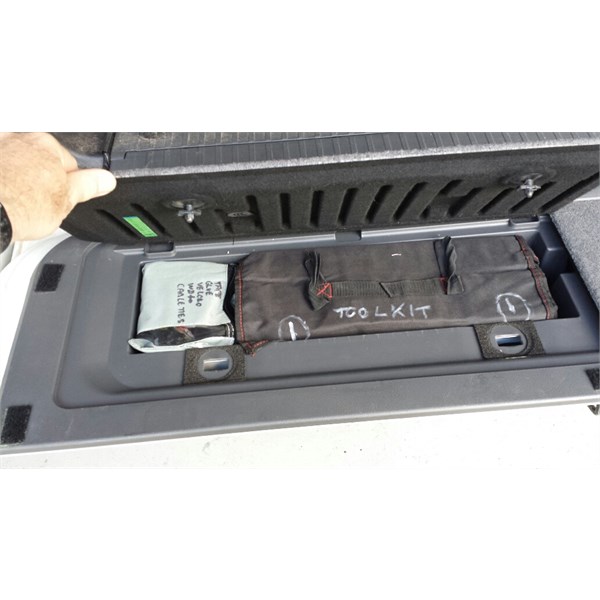

I've been through the same exercise on the 200. Tools are not much different to any other Landcruiser.
I carry a basic tool roll in the spare space in the tailgate (on the LHS) all the time and add a comprehensive bag of tools/repair stuff when doing a remote trip.
For the tailgate tool roll you should be able to fit:
-10/12/13/14/17/19 ring/open. I also add a 8" shifter to cover anything else.
-10/12/13/14/17/19 3/8 sockets with extension and slim ratchet handle. Slip a length of fencing wire through the sockets to hold them together (there's your spare fencing wire!)
- Metric hex set - critical ones are 5mm hex for the fuel filter and 10mm hex for the front diff
- Long nose pliers
- Screwdriver handle with a collection of bits - occasionally you need a torx bit as well as the usual screwdriver bits. Plus mini screwdriver set for fixing gadgets.
- multitool for the knife etc
- long punch
- file
- metric taps 6x1, 8x1.25,
- small WD40, Locktite 406 superglue, duct tape, spare velcro in a small bag
Hammer lives with the tent pegs.
There's also the standard tools packed with the jack tools - That's the pliers, double screwdriver and 10/12/14/17 open spanners.
Out of interest my big kit in a bag contains welding kit, soldering, large spanners (incl 15/16th for the rear diff and transfer), rivet gun, 1/2" socket set, specialised spanners etc etc

Follow Up By: Member - OzBadDude - Thursday, Mar 27, 2014 at 15:07
Very VERY helpful. Thank you!!!
