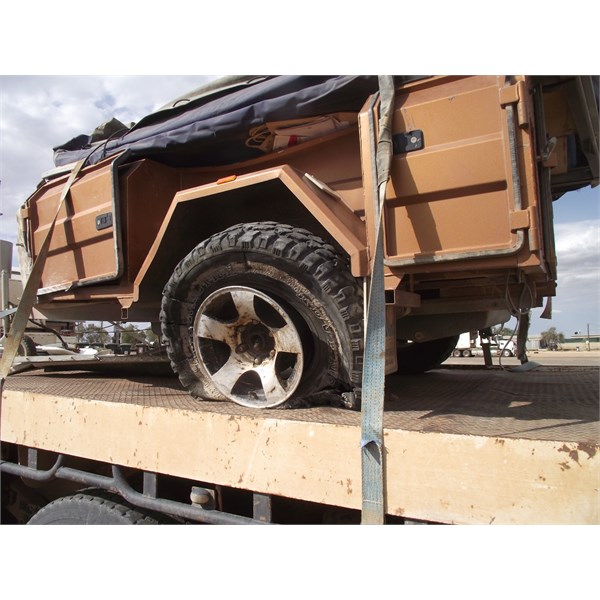

Reply By: Allan B (Member, SunCoast) - Wednesday, Jun 04, 2014 at 17:14
Here's another, at Birdsville. Not mine thank goodness.
Don't know what went first, the tyre or the bearing! I'd guess the bearing.
AnswerID: 533747
