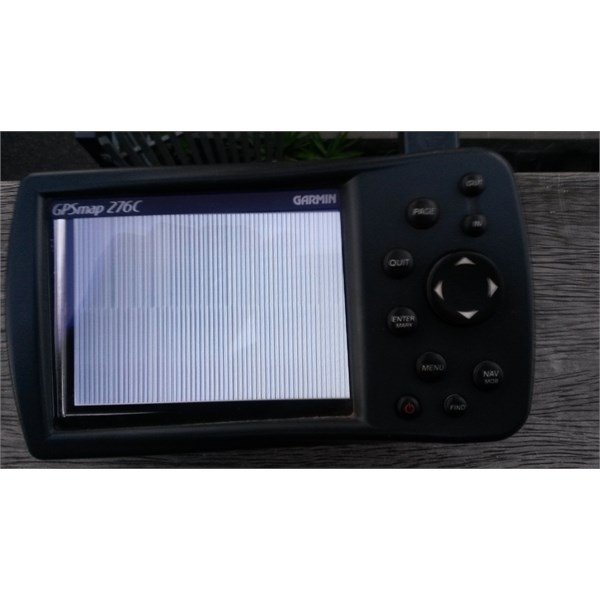

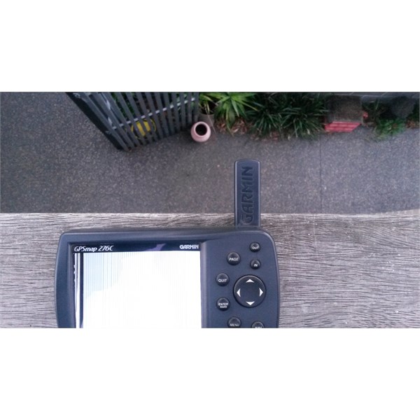

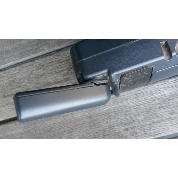

Just 4 days away from a three month plus outback journey I was programming my trusty Garmin 276C. As I will be staying a night at the
Clare CP I put all the details of it in too. I then went out on to my balcony at home to get a fix and see how far it was. My Garmin is 10 years old and is a bit slow at getting a fix if not used every day so I sat it the balcony rail which is 14cm or 5" wide. A gust of wind came from nowhere, no doubt ably assisted by Mr Murphy, and do I have to say what happen next.
Looks like it fell on the aerial
Looks like the circuit board has moved
The balcony rail
While most will probably sympathize with my plight "The Explorer" Greg is likely to be saying good riddance to bad rubbish. LOL

If you are inclined, I don't mean leaning to the to the left as at the fence, you can open the device and relocate the screens rubber/carbon impregnated, conductive strip so it again lines up with the gold conductors in the screen. The drop will have side shifted the screen one way.
As you open it it should be evident which way it has become and some effort to correct it may see the unit work again. Only you will know how it is constructed when after you use the can opener/screwdriver.
Held closed with pointy pliers, the aerial crack may seal and hold with a decent quality cyanoacrylate adhesive ie, super glooooo. I use Black MAX Loctite for many repairs in car stuff. everywhere it touches will become permanent BLACK so use carefully.

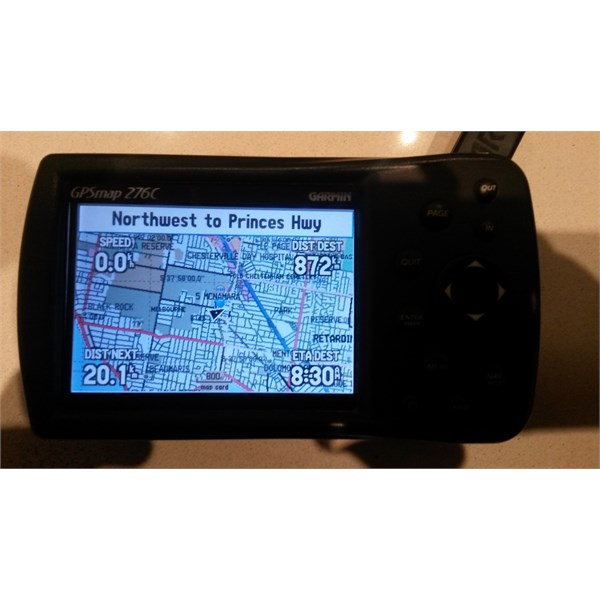

Ross M, what can I say, other than you are brilliant. As a tinkerer from way way back I thought after a fall of 4 metres on to concrete (and it would have bounced as it was 5 metres from where it landed) that it would be terminal so did not even contemplate opening it up and having a look. Your post prompted me to say what the hell lets have a go. Many years ago I got HOW TO on replacing the 3v internal battery with pictures, so I looked it up and away I went. I pretty
well did as you suggested and this is the result.
It is 872 kilometres to Clare SA
Ha Ha Mr Murphy beat you this time you basxxxd. Thanks again

Follow Up By: Ross M - Friday, Jun 27, 2014 at 23:18
Is it Rimmer or Clyve?
Good Lad You have done good.
Nothing ventured nothing gained they say.
I would suggest you use a hot melt glue gun and carefully put spots of glue between the case structure and the screen side capture frame. Two reasons, any slight knock may dislodge your work and the glue being slightly elastic in nature will cushion any sudden hits, knocks.
Ross M
FollowupID:
818950
Follow Up By: Idler Chris - Friday, Jun 27, 2014 at 23:51
The penny has dropped never heard of Rimmer or Clyve. A quick google told me what you meant. No it is not but if you look closely it is actually printed.

Follow Up By: Ross M - Saturday, Jun 28, 2014 at 00:49
Ah Yes, I didn't connect that it would be doing that. Smart device.
