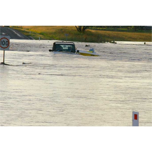

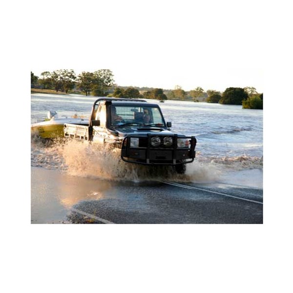

You can be lucky like that guy who took a new VDJ79 across the Condamine flooded river 2008.
I would not like to buy his car after.
AnswerID: 543998
Follow Up By: Slow one - Friday, Jan 09, 2015 at 20:54
Serendipity the vehicle would be ok as long as he checked his oils and from my experience which involves many, many vehicles that had a long history after the crossings, alternators didn't play up unless mud was involved.
Yep your post shows what a moron that bloke was with but the son sitting in the passenger seat. He had the balls of an elephant and the brains of a flea.
FollowupID: 831113

That bloke is just dead lucky that his 79 series ute didn't end up well downstream and a total write-off.
If it was one of the concrete crossings in the North of W.A., you wouldn't be able to stand up on it, even with only 300mm of water, due to the deadly slipperiness caused by the amount of green algae that covers the concrete.
More than one roadtrain driver has found himself travelling downstream after trying to negotiate what he thought was a modest depth of water over one of those concrete crossings!
