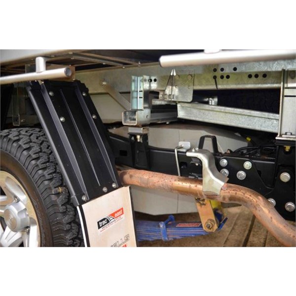

I have Out of Town Long Ranger tanks, and had them on two other vehicles. I have found them to be of good quality and service excellent. They have been making them for years…
I had them make a larger main tank, and custom auxiliary tank for my vehicle, Toyota 79 Series dual cab.
The following picture shows the larger main, and the auxiliary sitting above and forward of it.
Cheers, Baz - The Landy

Follow Up By: wombat100 - Monday, Jan 12, 2015 at 12:53
Sure looks nice & clean under there !!

Follow Up By: The Landy - Monday, Jan 12, 2015 at 14:51
Was before about 20,000 klms of outback travel last year...!
Cheers, Baz
