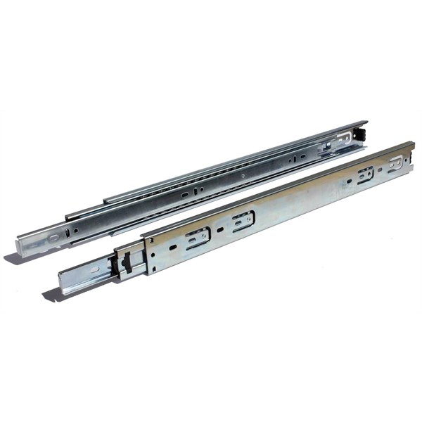

The problem with drawers that slide out 100% is that they have to use full extension rails which are quite frankly, rubbish. They are designed for internal household use. They use exposed ball bearings running between two tubes of steel. After time grit and dust gets in and the ball bearings grind themselves away to nothing.
We get numerous calls from people wanting to purchase our fully sealed stainless steel roller bearing system to replace their failed units. They are commonly used by "back yarders" and manufacturers who do not invest the appropriate money in machinery to do the job properly.
Our gear is cut on a fully computerised CNC Router as is any high quality, properly engineered, equipment. The photo I have attached is what you want to avoid if you want drawers that will last.

They have been great. Strong. Carry heaps of weight. They don't slide out 100% but I'm happy with that. The cantilever load on the slides would be huge.
