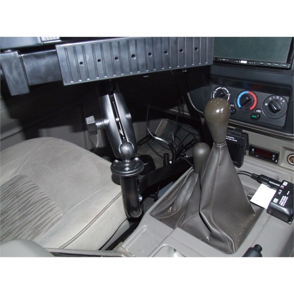

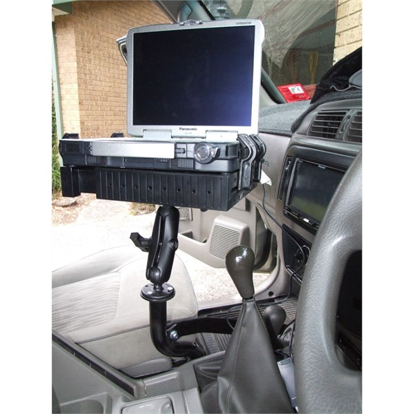

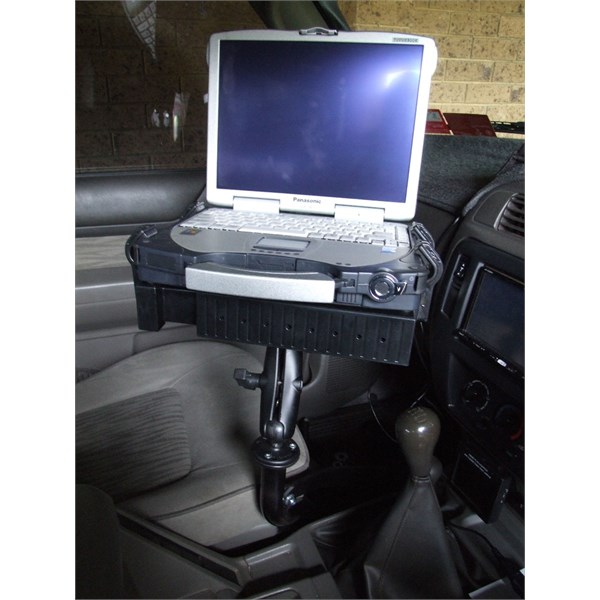

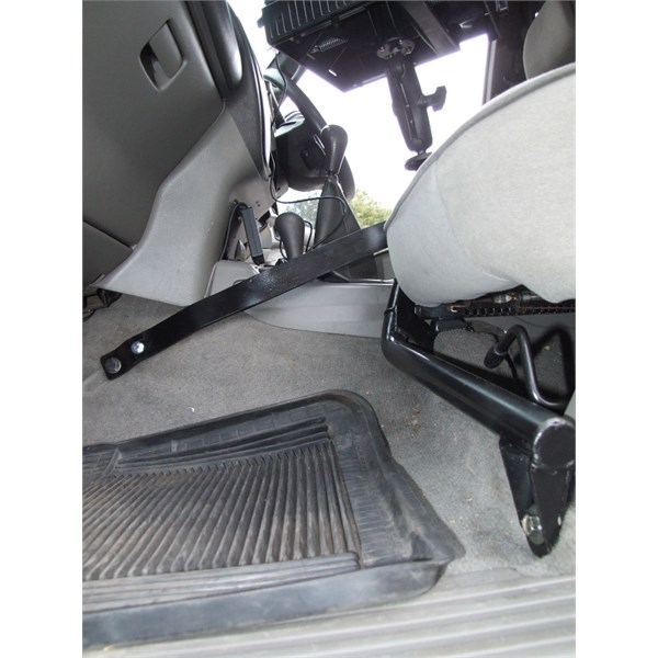

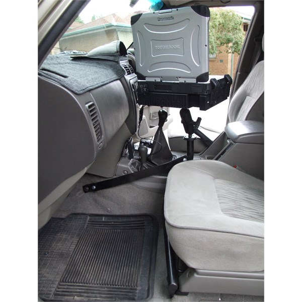

As Bigfish has pointed out, the flexible legs will do exactly that….flex. I’ve used one and threw it away in disgust on the first trip into the hills.
Using the Panasonic myself, you really need to fabricate a solid steel base up. Mount the 25mm RAM mount ball system on this and used the heavy duty laptop tray. I had one fabricated for my GU3 and then for the new 79 series. It uses the existing seat mounts and an anchor point for the centre console on the passengers side. I will post some photos from home tonight.
Both were manufactured by Brown Davis in Bayswater (eastern suburbs of Melbourne). Ask for Kevin Sharp there. Kev may have kept a template for the unit.Mine have proved tom be rock solid in any conditions.

Mate it would be a bit unfair as it was 8 years ago for the GU and five for the 79. On top of the RAM parts, the cost was comparable with the flexible leg system (back then). Speak with Kevin and let him know you've been talking to me.
P.S. I'm probably going over to a windows based tablet for navigation so this system is still great for that as well. Ram also provide other options for the tablet mount utilising the 25mm ball. You really need the larger ball and arm for rigidity.
Mick
FollowupID: 837352
Follow Up By: Mick O - Monday, Mar 30, 2015 at 23:01
Photos as promised;
