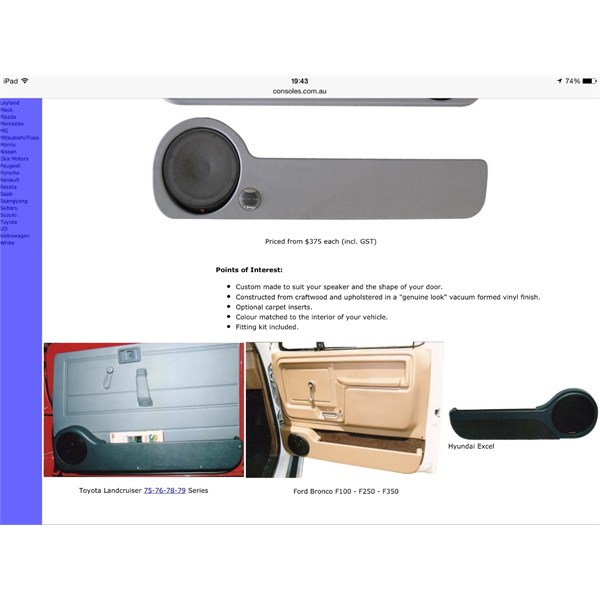

Follow Up By: Bob Y. - Qld - Thursday, Apr 30, 2015 at 19:47
Dept of Interior also do a speaker/door pocket. See below:
Probably a bit dearer than the 2nd hand alternative, but they appear to make good gear.
