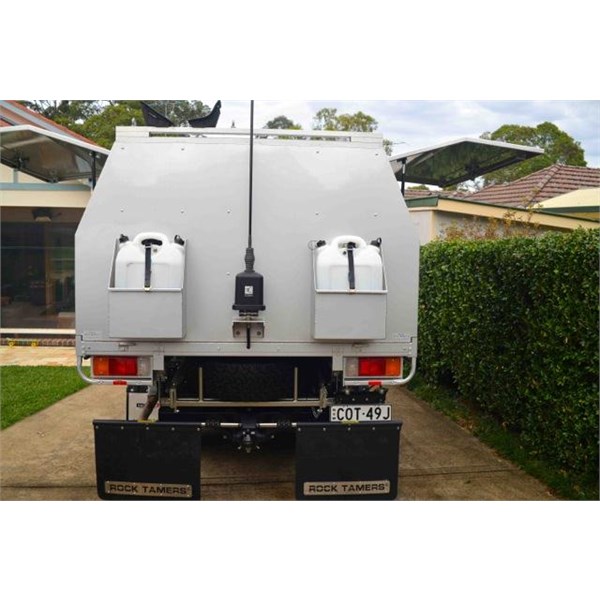

Follow Up By: The Landy - Wednesday, Jul 15, 2015 at 18:49
No problem, and not the same vehicle, but this is how we have outs mounted...might give some ideas.
Cheers, Baz

Follow Up By: Allan B (Member, SunCoast) - Wednesday, Jul 15, 2015 at 22:10
Hey Baz,
Isn't that a Codan 3040 antenna and isn't it supposed to be installed with the whip fully above the roofline?
FollowupID: 843375
Follow Up By: The Landy - Wednesday, Jul 15, 2015 at 23:19
yes, it is 3040, not sure where I got 3050 from. It has the whip that attaches to the section I have on there. Possibly not optimal positioning but works okay.
Cheers, Baz
FollowupID: 843376
Follow Up By: Member - ACD 1 - Thursday, Jul 16, 2015 at 11:38
My 3040 is fitted to the top of the rear wheel carrier (about the same height as Baz's).
It was fitted by the radio mob who installed the radio.
I normally just run the stainless steel whip, but if I need better reception, I put the short fibreglass whip that you can see on the back of Baz's Latoya (never sure if it's called the Landy or Toyota LOL)
Anthony
FollowupID: 843380
Follow Up By: The Landy - Thursday, Jul 16, 2015 at 11:48
As a matter of interest, on a trip along the Anne Beadell last year, the whip went under a branch of a tree and came back with enough inertia and force to crack the solar panel on the roof.
Note to Baz – Take whip off when under trees!
Cheers, Baz
Hmm...Boyota?
FollowupID: 843381
