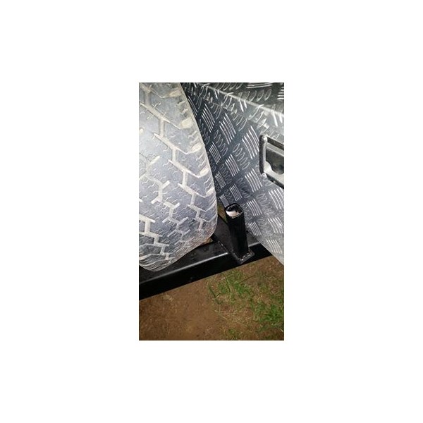

Recently bought a preloved camper trailer. Have no idea what these parts are for, the manufacturers of the trailer said they didn't put them on so they must have added them in, I'd love to know what they are for :)
Basically the two smaller bars wither side of the spare wheel bar :)

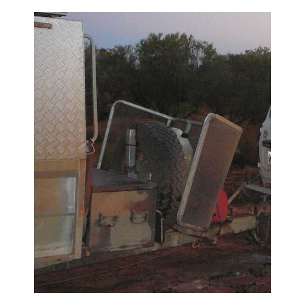

Could be a removable stone deflector mesh, frame dropped in there? Cheers.

Kanga, tend to agree given I can't think of any better use for those... maybe something along the lines of this.....

Wouldn't the tool box be in the way?

Not necessarily ...... depends on the shape of the stone guard - they come in all shapes & sizes... the one in my photo was custom made for that trailer.

Looks like a spare wheel or second spare wheel carrier. The bolt on the centre post might go thru one of the wheel nut holes and the flat bit on top of it might locate the wheel centre. The whole tyre would then sit on the "A" frame.

spare goes on the middle pole with that bolt.. but I don't know what the two smaller poles are for?

It looks like they are there so the tyre has something to bear against when it is clamped down.
3 points to clamp against will give a lot less movement than 1 or 2.

I thought that could be a possibility too but they are behind where the wheel sits anyway

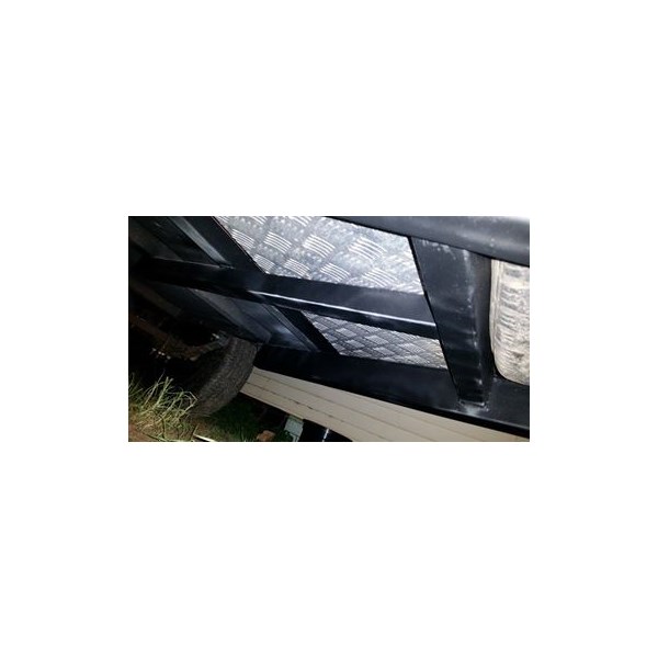

Just looking at the pic......I hope the weight of the spare tyre will be borne by the A frame. If there is ANY weight being carried by that main upright, I would be adding a gusset between the upright and the cross member. As it stands now, there would be substantial stress on that weld if there is weight on the joint.

Hi, not really following you or sure what a gusset is? I'm not very technical with these things. We recently had a brand new trailer from some well known manufacturers and personally I think the spare on this looks more supported and secure There is three supports two from the A frame and one that runs a fair bit under the trailer
