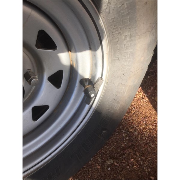

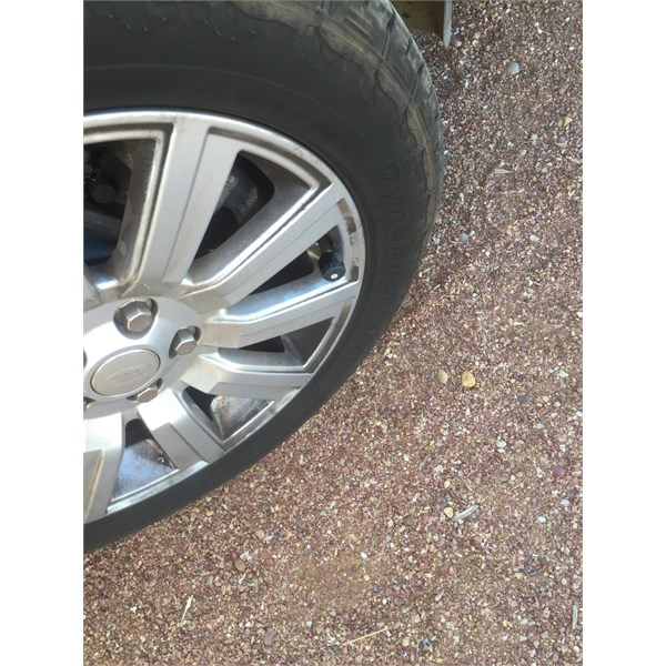

I have external tpms on my car and van
I have been traveling for awhile with only a small amount on dirt road and have noticed my rims are being scratch my the tpms sensor.
Has any one else had this and have a solution.
Has anyone experienced other issues from using these tpms sensors eg to the valve stem
Rich

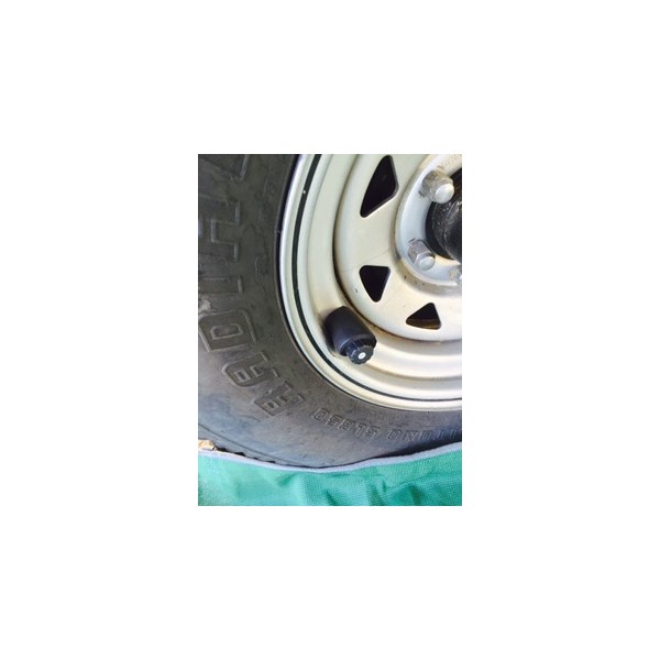

Reply By: Member - Rich - Monday, Sep 14, 2015 at 17:30
As suggested I got some of the insulation tubing from burnings which slips over the valve stem and even the bottom part of the sensor
