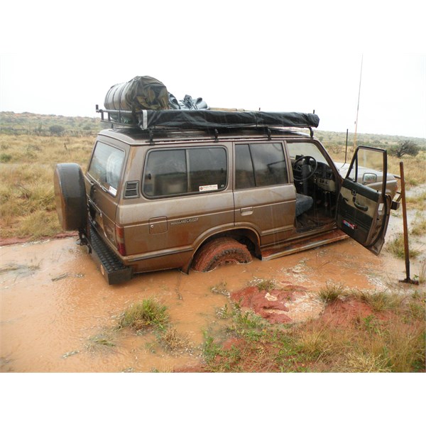

G`day Phil,
Custom Splice (Google it) is the mob I bought from, if I remember correctly it`s "Blue Steel Co" of USA. There is plenty of choices on their website.
I disagree about using a short length, 10mm dia X the longest length that will fit the drum is what I use and recommend, I have bought an extra 12mm X 40 mtrs length to use as an extension for when required.
Prior to changing to Dyneama rope there were two occasions when I have been in serious trouble and have wished for a longer winch rope, one time I burnt the winch solenoids out because I had to use a single line pull.
Just my opinion,
Scrubby
