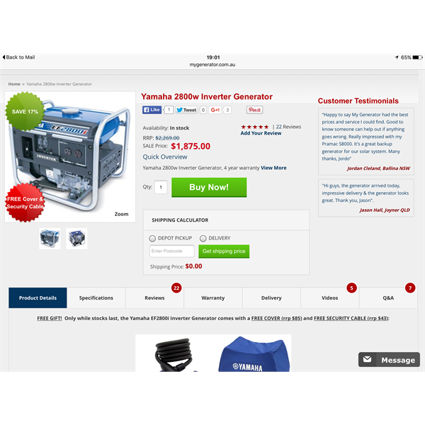

Unless you can get the Ibis retro fitted with soft start cheaply, you might be better off buying a 2800w gennie, rather than invest $1900 in the inverter system. Only downfall might the increased weight, and manoeuvrability of a bigger generator.
Found this on Google:
Find it here.
No affiliation etc...
AnswerID: 591517
Follow Up By: Member - Bigred13 - Monday, Oct 12, 2015 at 21:32
Hi Bob, Yes that 2800 W Yamaha will do it easily ,I've got one and I used it with an Air Command Cormorant ,which I believe is the biggest one they make ,and it was no problem ,I think it has the easy start too on the air Con .+I have a Coleman Mach on the caravan now and it starts that and runs it as well as a turbo cooker ,although it is really working with them both going
Regards John
