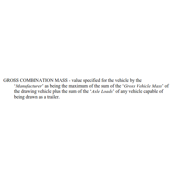

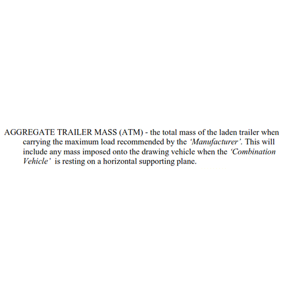

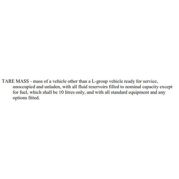

Further to what has been discussed, I like to go to the source of the legal definitions and use them. You will fing them in "Vehicle Standard (Australian Design Rule – Definitions and Vehicle Categories) 2005." The ones that the OP enquired about are:
If you go to VSB-1 you will find a definition of Tare Mass that applies to trailers alone.
In addition Darian and Tom have introduced a further weight that is needs to be observed
You may note that the definition of GTM here is at odds to the definition that Darian gave. Even the jurnos get it wrong.
FollowupID: 860059
Follow Up By: TomH - Monday, Oct 26, 2015 at 14:41
True except that tare definition is for a motor vehicle NOT a Caravan.
A caravans Tare should be the weight as it leaves the factory with NO FLUIDS OR GAS
Anything added later comes out of the payload
Here is the best description of the weights I have found so far
http://www.caravancouncil.com.au/#!compliance/c1pna
and click on Ratings and Masses and a PDF will come up
That document of Darians Towing Guide is a bit misguided I reckon
FollowupID: 860064
Follow Up By: Nomadic Navara - Monday, Oct 26, 2015 at 15:21
That tare mass definition applies to all vehicles. "Unoccupied and unladen" means no gas, water or diesel in the diesel heater tank. They are part of the load.
FollowupID: 860067
Follow Up By: TomH - Monday, Oct 26, 2015 at 16:57
Im sorry it doesnt It refers to a motor vehicle which has its radiator and sump full and 10 litres of fuel. As it says quite plainly in the definition if you read it in its entirety
A vans tare is its dry weight with no fluids or gas. To be exact water tanks, empty HWS empty, toilet empty, gas bottles either empty or not even there as in my van that came without them. It only includes what is on it when leaving the factory and if it doesnt have an aircon or an awning then they have to come out of payload.
It would also pay to weigh it yourself as some vans may be well out of wack with whats on the plate.
Jayco say they weigh each individual van. My Roadstar was about 140kg over the plated tare when I bought it
From Caravan World
Tare Mass
Tare mass is the weight of the caravan as it leaves the factory, without water in the tanks, any gas in the cylinders, any luggage or personal effects whatsoever. It is also without the weight of dealer-fitted extras, such as an awning, air conditioner and so on. If you subtract the Tare from the ATM, this leaves you with the maximum payload weight you can use to load your van.
FollowupID: 860075
Follow Up By: Nomadic Navara - Monday, Oct 26, 2015 at 22:56
Tom, you can prattle on all you like. When you are dealing with legal things you have to go to the legislation. The definitions in the document that I quoted are the legal definitions used for the things we are talking about. That is the only definition of Tare Mass in the document. The definition includes things only found in powered vehicles because it is the definition for all classes of vehicles. There is no other definition in that document.
There is however another document that is a collection of bits and pieces relevant to trailers, that is VSB-1. The definition of tare mass in that document has been extended to only cover. If you wish to quote another definition you should be quoting that one. Any definition you quote from another source has no force in legislation, it is just a paraphrase or interpretation of the definition defined in legislation.
FollowupID: 860094
