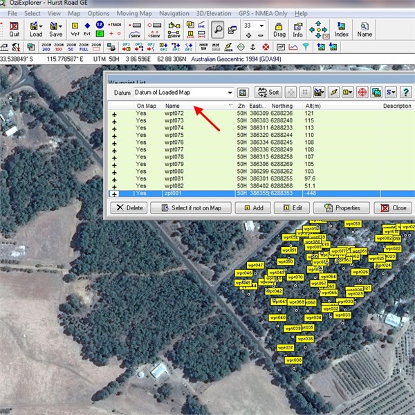

No expert but it would appear point files are listed in order based on the PID column with no option to use other columns (i.e. point name etc). I have no idea if this will solve your problem but if you save your points file as a waypoint file, then open this file and then click "show the waypoint list", you will be able to sort using the waypoint number by clicking on the NAME header (assuming your "logical path" = waypoints in number order).

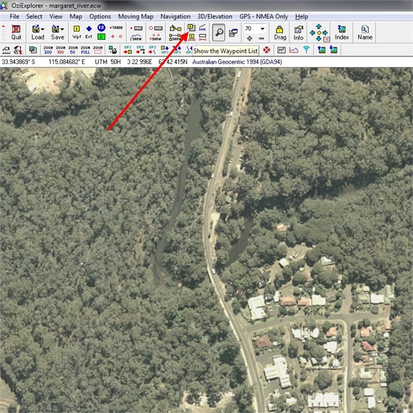

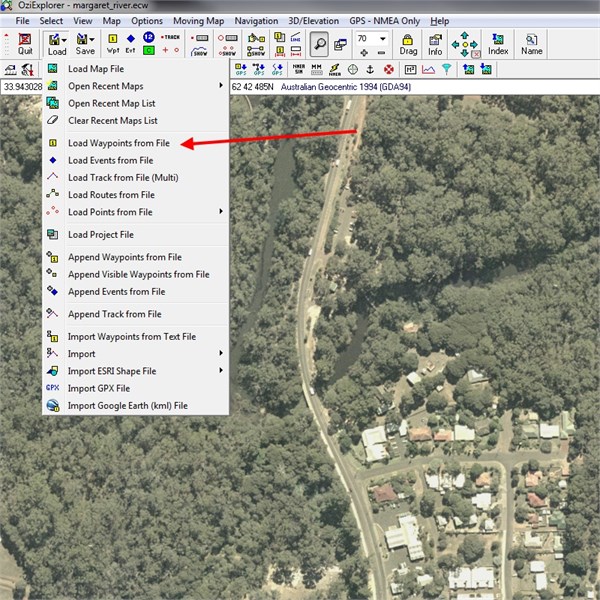

OK, just to make sure I'm on the right track (pardon the pun), I have a waypoint file (.wpt) and have loaded it by selecting "load points from file...waypoint file" into Ozi. I can then select "show/hide point control" and then I can select "show the points list" which gives me a list of waypoints. Its here that I've tried to edit the sequence by altering the numerical "name" in the names column but as I said, it seems the PID column determines the order.

Just load the waypoint file as ......a waypoint file, not a points file.
Then open waypoint list
You can then sort the list by waypoint name (ascending/descending - numerical/alphabetical) by clicking on the Name header once. Clicking once again reverses order. You can also sort by Description in same manner.
