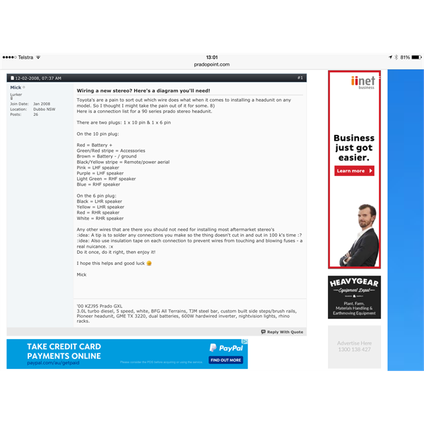

Don't know that I can help you, Beastly, as I've only had my V8 about 5 weeks, and haven't ripped the dash open yet. :-)
Before I started the refit mentioned above I googled "Landcruiser stereo wiring" or words to that effect, and got a couple of options to follow. Think most examples were of 100 series.
Did copy a couple as below:
I found the 2nd image to be the most useful, and colours matched with my '02 model. I had bought numerous Toyota/Sony adapter plugs/looms, but none of them would match properly, so I just slowly soldered & hearshrunk every join. Sounds alright with no distortion at all.
If I can help anymore, yell out,
FollowupID: 860603
Follow Up By: beastly666 - Saturday, Nov 07, 2015 at 13:45
Sadly it doesn't work for my 79 :(
