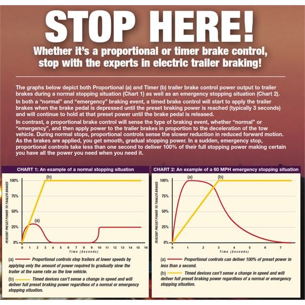

Hayman Reece controllers are made by Tekonsha - see this link However the Sentinel is one that Tekonsha have deleted from their range because it is old technology. It is the type that is called a synchroniser or timer controller.
Do not keep it. It's better used as a paper weight.
I would suggest that no one uses one of the synchroniser types. The explanation below shows why you should opt for a proportional type.
