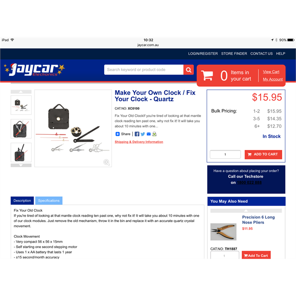

Follow Up By: Bob Y. - Qld - Sunday, Dec 13, 2015 at 11:38
Jaycar have these clock kits too. Cat No. XC-0100. At $15.95, they would be cheaper than the units I posted above, but whether they last as long..............?

Follow Up By: noggins - Sunday, Dec 13, 2015 at 12:40
Yep They're the ones I was writing about > Didn't realize that Jaycar had them

Hi Ron,
yes went to spotlight and saw the ones your on about but thought cant be then as their SQUARE ??? didn't realise it was the inard , but I cant for the life of me take it apart I got the face of OK but buggard if I can see how to get that back off ?
FollowupID: 862076
Follow Up By: danda - Sunday, Dec 13, 2015 at 17:11
Stop press the lights gone on and all is now clear,Ron your a bloody genius mate had I known the inard was square I would've fell in sooner but yes what a great idea, HUGE thank you for that mate BTW for any interested once the clock arms are off it's just a matter of prying it apart and then fitting the new inard and yes its one of those once you've done it it then easy to do,
Thanks again Ron,
cheers,
Dave
