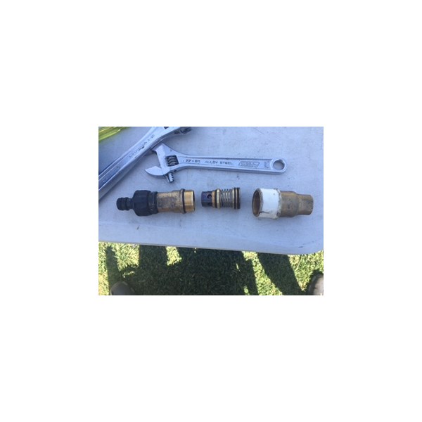

I have recently had the same issue. I resolved it by locating the pressure reduction/one way valve. Mine was located where you plug the water supply hose onto the van. It was a brass fitting about five inches long.
Before you pull it apart, try hitting it in the middle with a hammer. Apparently, the spring inside sometimes gets jammed and can be loosened without pulling it apart.
If this doesn't work, use two spaners to disassemble the valve, noting (photographing?) the order. Blow or wash it out and re-assemble with plumbers tape.
This worked for me but I didn't know about the sticking spring before disassembling.
Hope this works for you.
I'll attach a pic.
