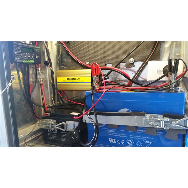

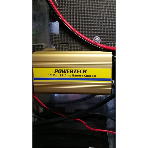

I have this powertech charger in my camper. Can I or should I keave it on 24/7?
It basicly stops when battery is charged. I can hear the fan spinning and charger wirking harder when battery is low on voktage and then it basicky shuts down when its charged.
So, how woukd you all go about it? Leave it on 24/7, turn it on for a day or 2 now and then? Any ither suggestions?
Its charging a 105ah full river battery.

It looks like you have the battery permanently mounted, but only connect the 240v supply when required.
I would be replacing the clamps with lugs and having the charger output bolted to the battery posts.

first bolt down the leads instead of using clips [clips may give false reading to charger]
Have an isolater switch fitted in the negative cable . This completely prevents any parasitic loads from draining the battery . EG solar controller or any lights left on .
