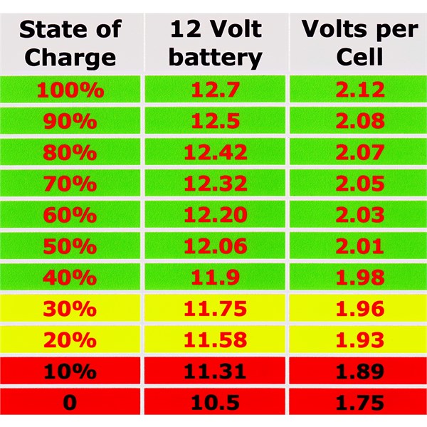

For all those interested below is a scale of 12v battery volts I have come across .
Cheers Dodg.
AnswerID: 597302
