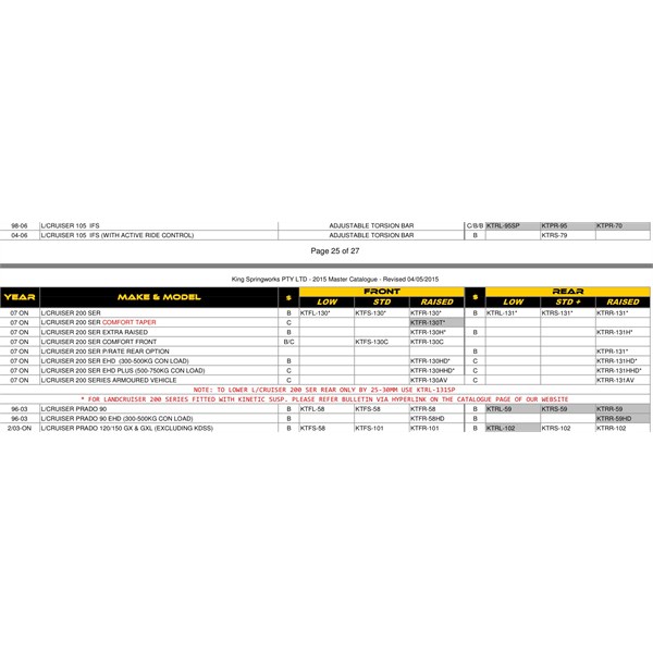

I found a pair of King progressive springs were far better than airbags.
When empty it sat more level than with originals and still rode soft enough. When loaded the hard bottom half of the springs held it up better.

Here's a grab of the Kings Coil Spring catalogue for the 200 series.
Few different options available there?
