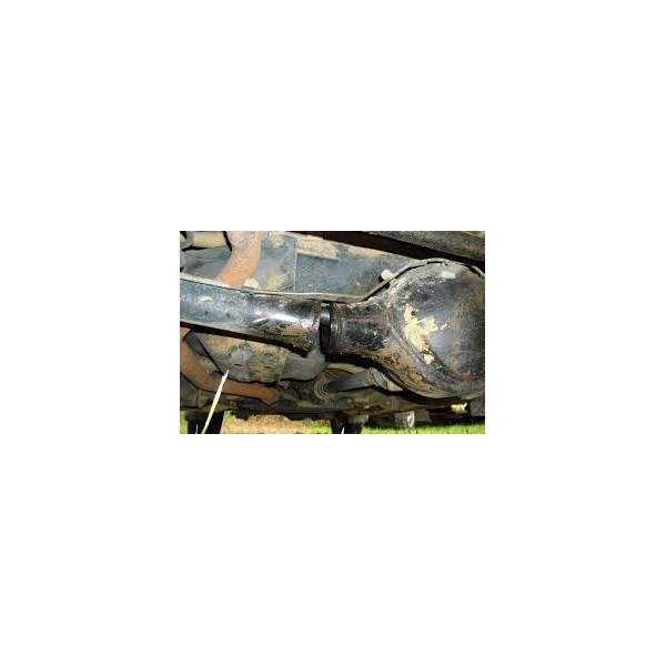

There is only so much weight that you can put into a car before something breaks, particularly on Outback roads or tracks. If you break an axle housing or crack your chassis out there, you won't be the first to do it. If you ask Nissan, the company that is not a dealer, there is a good chance they will tell you to reduce the load on the car in those conditions, not take it to the maximum or beyond.
As Les said,have you worked out your fuel consumption in those conditions? The only sand hills that I have taken my current car over (diesel Hilux) were on the Sandy Blight Junction Road. The fuel consumption between Kintore at the northern end and Giles weather station was lower than what I consistently get around the suburbs at home or on freeways. The reason for that was there was next to no speed involved for the entire distance therefore no wind drag. It is air drag that kills 4x4 fuel consumption. They all have the aerodynamics of a brick.
In those remote areas two spares can be handy but they are no guarantee that you will get through. I only carry one in remote conditions and remove the tow bar to save weight but I always include a couple of tubes and enough patches etc, to fix anything up to 50 to 60 mm tears in the sidewalls. Not all punctures in the bush are that big but many people have got them. In some cases the same piece of tree root or whatever have punctured a front and rear tyre at the same time.
