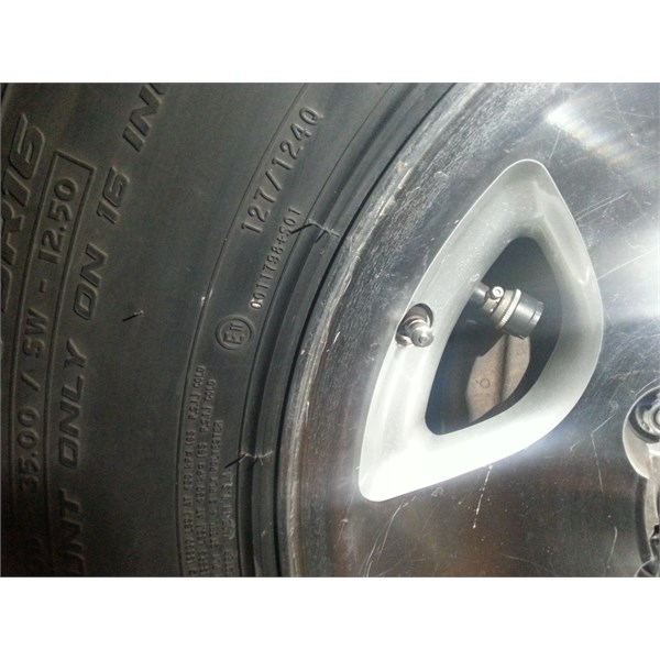

Reply By: Life Member - Terry 80FTE - Tuesday, May 03, 2016 at 22:02
I use the Tyredogs on stem, on both alloy and steel rims.
But drilled a new hole inboard a bit and used the shorter Go-cart valve stems,
The valve points in towards the axle so centrifugal force doesn't lay them outward, also they are more protected from sticks and stones.
Other advantage is they don't have to be removed to air up or down, just use original valve.

Follow Up By: Member - ACD 1 - Wednesday, May 04, 2016 at 09:43
Terry
You may be on a winner here. Can you post a photo to show what you've done?

Follow Up By: Life Member - Terry 80FTE - Wednesday, May 04, 2016 at 22:30
Hi Anthony,
On these Alloys after drilling the extra hole I then countersunk the hole a bit as the alloy was thicker than the steelies

Follow Up By: Member - ACD 1 - Wednesday, May 04, 2016 at 22:41
Thanks Terry
I take it you have no issue with the balance ? I suppose a bit more weight wouldn't make that much difference given big 4WD tyres are notoriously difficult to get to zero.
Did you do the drilling yourself or at a rim maker/repairer?
Thanks again for the photo. I will now invest in a set god the L/cruiser and trailer.

Follow Up By: Life Member - Terry 80FTE - Thursday, May 05, 2016 at 22:58
They were done in the workshop, prior to tyre fitting and balancing,
