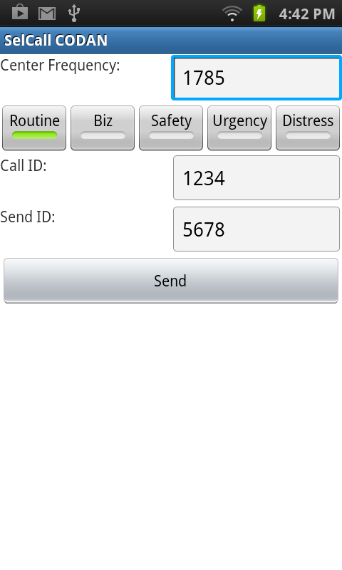

This may be also of interest.
There is an android app called Selective Calling Generator.
It has a Codan Selcall mode ( which Barrett also use). I tested it on the VKS network and it works well. In addition to being a good plan B for your trip, it is a great thing to have ongoing. No Telcall though.

Follow Up By: KSV - Wednesday, Jun 15, 2016 at 07:53
Thanks Boobook for pointing me to great little app - I never knew that such stuff exists. Though very little interest for me without TellCall.
Serg
BTW I cannot see your embedded picture :-(
FollowupID: 870769
Follow Up By: Member - Boobook - Wednesday, Jun 15, 2016 at 08:24
Hmm don't know why you cant see it. It is on my browser. Anyway go to the link and it is one of the pics if you scroll across.
Read their text carefully, It may do Telcall now. Its a few years since I tried it and I did request it as a feature then.Maybe...
