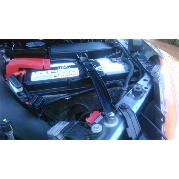

Thanks for the tips and link, I've just ordered a superstart 75ti, from the measurements L-315 W-175 and H-190, the only modification may be the braket as this battery is same length and width as the Fomoco 730caa standard battery fitted, and about 10 mm higher, cheers
AnswerID: 602084
Follow Up By: Member - croaky - Saturday, Jul 09, 2016 at 09:38

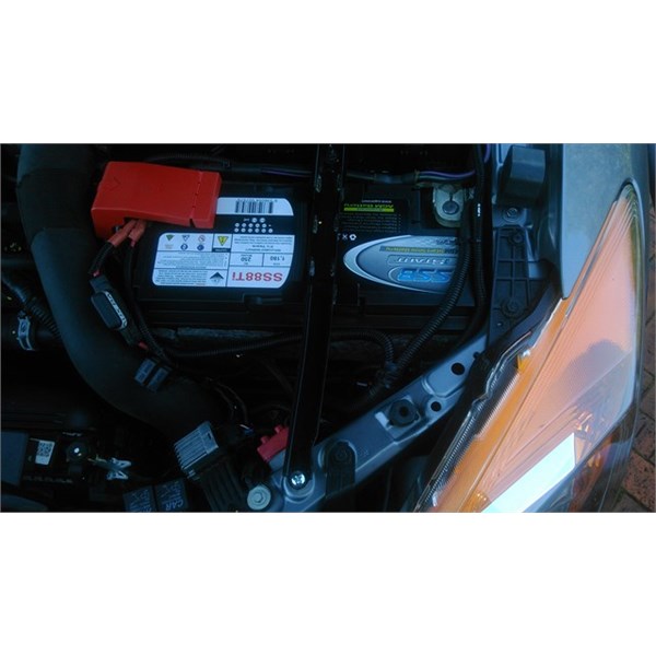

I went for the even larger SS88Ti (1,189cca 92AH, a beast of a starting battery;-) as I like to go for the max, and it just fits in, very snug fit requiring careful maneuvering of wiring and terminals to get it in, it would be helpful to have another set of hands, but I did manage by myself.
Modifications; to plastic battery holder base (under battery), I cut both ends out to facilitate longer battery.
Also put a nut and longer screw in the top braket as this battery is 10mm higher. And red plastic +positive terminal cover clip under earth lead need trimming.
Pic attached of fitted battery.
I'd suggest for most people to go for the SS72 or the 75Ti so it is easier to slide in.

With the bigger battery are the terminals still recessed so they don't short on the bonnet?
AnswerID: 602220
Follow Up By: Member - croaky - Saturday, Jul 09, 2016 at 09:40
they are recessed (DIN battery style), I just added a couple of pic to thread.
There is plenty of clearance, I put putty on battery and bracket and closed the bonnet, then reopened and checked putty, there is a good 40 mm clearance on battery and 20mm on front bracket where I've lifted it about 9mm using a nut as washer and longer screw.
