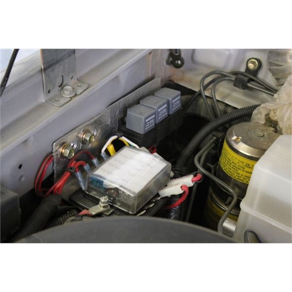

Thanks for the replies. I'm sure this thing had relays as well as fuses - like maybe 5 relays and 10 fuses - really easy to hook up to a single power supply then have all your aftermarket systems running out of it. Kind of like the car's OEM box but neater ;0)

Yep, try here
Fuse box with relays

One thing to remember is that you can get mounting blocks for square automotive realys that lock together in a strip and you can buy relays that plug into them that have on board blade fuses.
These are great for making headlight upgrade relay sets.
Getting a realy good comoning block remains a bit of a fiddle.
some of the lightweight fuseboxes have both hot and cold common strips.
For the heavier stuff I buy brass bar from George Westons and get busy drilling and tapping.
For a headlight upgrade relay set I will build a common by coming 6mm2 into a non insulated 6mm2 crimp barrel and twist together 4 x 1.5mm2 into the other side and crimp it, cover in adhesive lined heatshrink.
the 1.5mm2 lines go into the fused feeds of the relays.
