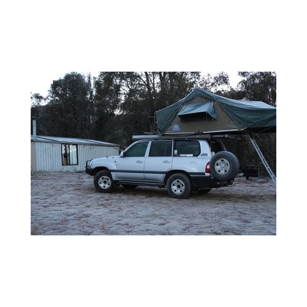

Sorry to tell you -- but happy we bought it. No ponding at all in our Hannibal. It has a hoop support that holds the annex roof up. The roof is also a bit higher than most tents, making the angle of the roof a bit steeper, which also helps.
Even snow, which can be heavy when trapped, simply doesn't gather and just runs off when it melts.
I didn't add the annex in this photo but you can see the bulge from the "hoop" in the annex roof. And the whole tent is tight with either tie down ropes or the annex added. It was late and cold and I didn't bother.
The hoop is just like a tent's flexible fibreglass "rib".
