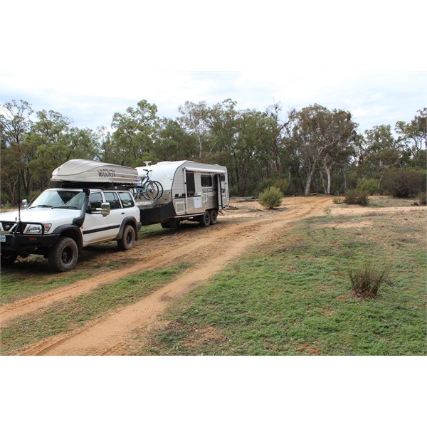

Reply By: Member - Eggo65 - Sunday, Aug 21, 2016 at 08:14
Time for an update.
I have given this a lot of thought, made a couple of mockups and trials and have finally finished the first prototype. Took it for a test drive yesterday and I must say I am surprised.
No noticable difference to handling, performance or noise.
Some details ... Patrol has an upgraded OME suspension, Tinny plus all roof gear weighs approx 100Kg's, fully loaded we are sitting pretty well spot on GVM for the Patrol 3020Kg's. Test run yesterday performed at various speeds up to and including 105 Kph even went along the beachfront to see what effect a side wind had on stability. We will be towing a Hybrid off road van so we will not be breaking and land speed records (most likely we will be sitting on 90-95kph). Again we will be within both GVM and GCM specifications.
As you can see the tinny has a custom made waterproof tight fitting cover.
I do intend to have the rack fabricated by a local engineering firm to ensure the load is distributed across the roof evenly.
Thanks to everyone for there thoughts and comments.
See you on the road somwhere.
AnswerID: 603644
Follow Up By: Batt's - Saturday, Aug 27, 2016 at 12:49
Looks ok but what about in a torrential downpour is the cover flat or raised like you would have set up on a ute. I had a hilux styleside ute yrs ago and it was a hot day then a storm unloaded ended up with a foot of water trapped in the back of the ute with 2 bent support rods imagine that extra weight on your roof. Other than that good luck with it.
