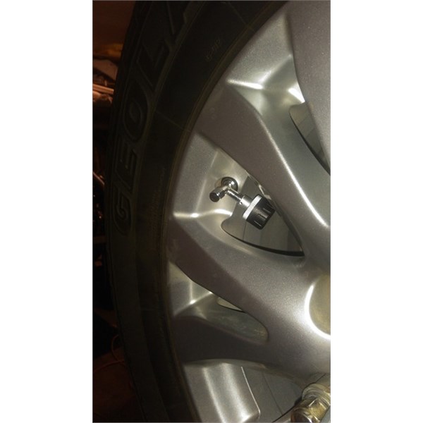

Interested in peoples comments about these T Valve fittings
Submitted: Sunday, Sep 25, 2016 at 10:37
ThreadID: 133494 Views:4452 Replies:7 FollowUps:15
For a while I have followed the various threads on tyre pressure monitors and their inherent damages from the external screw on sensor styles bouncing and being damaged by the wheel rim.
Plus the need for the sensor to be removed when tyre pressure is being changed or tested manually.
I have often wondered about a fitting that would "move" the sensor safely away from the rim and also alleviate the need to remove the sensor for manual testing or adjusting the pressure.
We found a"T" valve stem fitting here that appears to do the job and would like to hear any comments, particularly from users. All comments are always appreciated.
PS (edit) I would expect the sensor to be fitted on the base leg of the "T" and turned back inside the rim away from bushes, stones etc etc

When mounted the straight bit is much the same position as the current stems. So if the right angled bit is turned around to point "into the car" then it is back "inside" the wheel rim. ie tucked back in and out of the way. It would totally stupid to have it point"out" away from the car. Stupid. That's what I meant by "tucking" it back in.

If you look at the photo below the part mounted in the rim, like a normal stem, is only about 28 mm long. That's the straight one. The "T" section, as I refer to it, is 26.3 mm long and if rotated back into the wheel it will NOT stick out the side of the tyre. This would be where the sensor is fitted and well inside the edge s of the rim. Not sticking out the side. We don't need to access the sensors, hence being "back" inside the rim is not an issue either. I don't believe the sensor would touch the brakes but am yet to take a wheel off and measure the gap between the rim and the brakes at the out edge. Luckily having steel, the thickness of the rim "spokes" is a lot less than alloy.
Thanks Bantam
PS Edit here is another copy the photo that I was referring to.

As said we have the steel rims and the stem is more straight up towards the hub not off to the side like in the photo.
