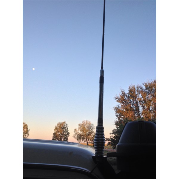

Follow Up By: Bob Y. - Qld - Friday, Oct 14, 2016 at 21:40
Thanks for the lengthy post, Bantam.
At the moment, I have a GME extended gain on the roof of my ute, photo attached, but a drama with coax needing to be resoldered at Mt Dare(thanks to my travelling mates, Steve & David, for solder & a 12v iron) I've decided to run a second aerial.
Have used just about every mobile aerial available over the past 35 years, and the stand-outs have been Polar 6dB extended gain, and the 6dB broomstick that I mentioned above, that are no longer available, because of production costs.
Am not worried about breaking bullbar mounted aerials, 'cause I've slowed down a lot these days, or will fit something like Malcolm suggested.
Thanks Bantam,
FollowupID: 874901
