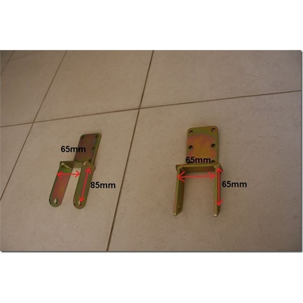

Follow Up By: Member - Hillel K (VIC) - Wednesday, Oct 19, 2016 at 16:50
Thanks for replys however there is no space for the clamp type bracket and with the L bracket under the DO35 hitch there is no clearance once the tailer is hitched .The bartwhen on the upper holes will also fowl the twin wheel carrier locks/handles. Christian from ss is away at the moment so will have to wait .thanks Hillel
FollowupID: 874965

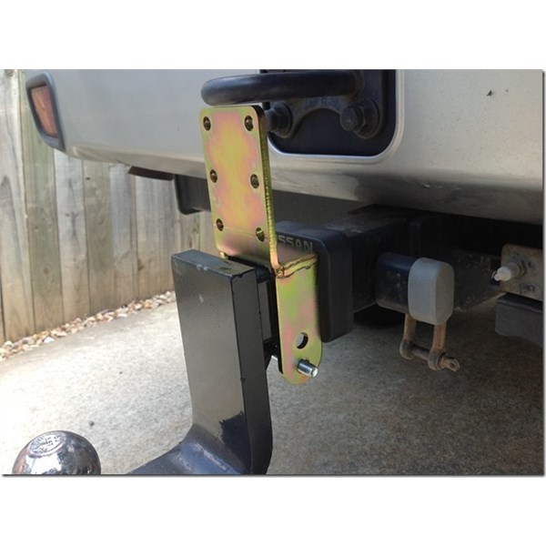

Follow Up By: Member - Rich - Wednesday, Oct 19, 2016 at 18:14
Christian supplies a number of different mounting brackets
At one time I used the one in the pic blow.this is not my car
What I did is invert the bracket
and mounted the bar under the tow ball tongue
If this leaves to bigger gap you can. End the bar appropriately
Richard
