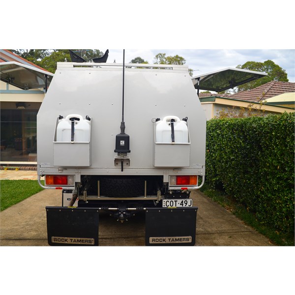

Whilst not a Hilux, we have our Codan 3040 auto-tune mounted on the rear canopy of our 79 Series with little to no degradation to performance that we can detect.
The whip sits well above the canopy roof.
Good luck with it, Baz - The Landy

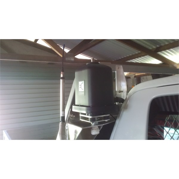

This is what I did.
I sold my 9350 and bought a 3040 as I didn't want to take up tray space.
Up nice and high while being lower than the tray upright so it gets some protection.
I had to make a model to give to the fabricator as it was a tight fit with the rear door, chassis separation etc on the Freestyler BT 50.
Steve

Thanks Steve,
That's a great idea - I was thinking of a similar approach - mounting it behind the bar or fabricating a bracket to mount above the wheel arch where I don't stack material day to day. My autotuner is an 8558 - probably time to upgrade when I reinstall it with something similar.
Jolls
