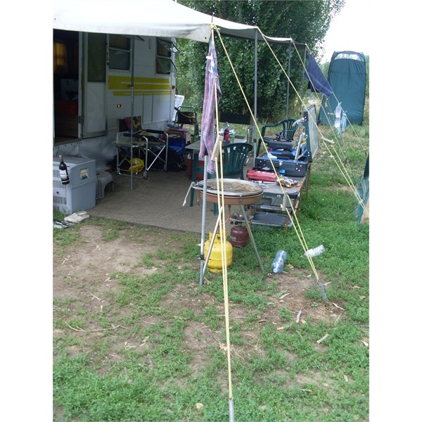

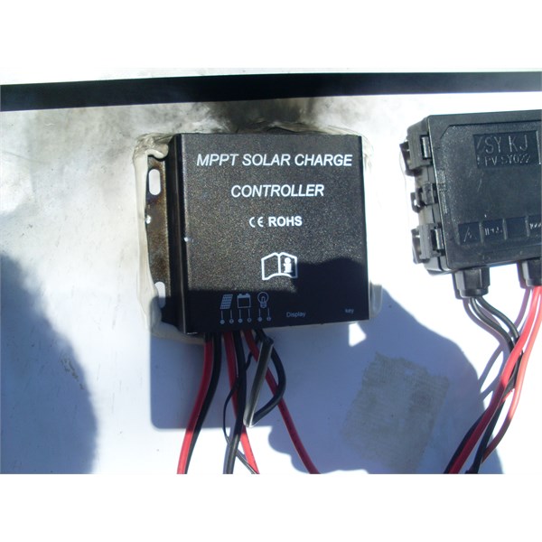

G'day all, on the 5th of Jan. this year we were camped on the Murray River & our camp was struck by lightening, including 2 of us! Smashed 1 panel of our 220w solar setup as it melted the regulator on fire. Should the other panel still be ok as it looks good, would I just need another mppt regulator? We were taken by ambulance to hospital for observation, it melted the battery in the caravan & the car parked beside

I would say if the regulator caught fire you'll definitely need a new one!
The panels are another thing, disconnect them, place them in the sun and see what
your getting out of them, you may find the open circuit voltage is ok, if not then look inside the terminal blocks and see what condition they are in, if the connecting tape is ok but the panels reading zero vaults in the sun then try cutting on wire going to the bypass diodes if it has one and see if you get any voltage then?
If the panels are producing reasonable volts a new regulator should get you going again.

Obviously the panel that is shattered and the regulator are damaged beyond repair.
You will have to test the other panel by disconnecting it from the damaged one. The plastic covers where the wiring comes out have two tabs on the side and can be opened.
Put the panel in the sun and a check of the open circuit voltage and the short circuit current should indicate if the panel is ok. Also as mentioned before also check the diodes.
Just as a side note, the regulator that was destroyed says MPPT. Sorry to say was not actually a MPPT regulator. There are plenty of YouTube videos about this.
A good quality PWM regulator such as the EP Solar series would be a good compromise between cost and performance.

Thanks Mal, wow even though it says mppt thats not the case!

yes Gronk, we were - what an experience to walk away from!! My partner had a burst blood vessel on the back of her head from the lightening going down her umbrella into her body & as she had thongs on I was leaning on her the current passed onto my arm & burnt it as it went to ground through me as I was bare footed.The shock wave threw us onto the ground!! The flash of lightening was so bright & the clap of thunder next to you is indescribable!! My daughter granddaughter & dog were up the other end of the awning to witness it all suffering only fright & momentary deafness! What did you see/hear about it then?
