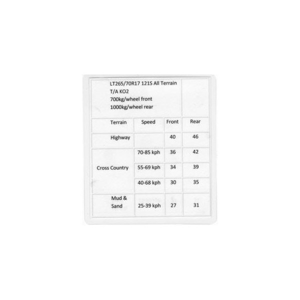

I made a similar query via an on-line form on the Michelin Aust website and they sent back the attached. I posted it here and the overwhelming consensus was that, apart from the highway pressures, they were too high. I agree.
On corrugations I run about 23 cold. They warm up to about 27-28. Reduced speed, of course

Not too high if you look at the /wheel loads. Most of us aren't at those weights.
