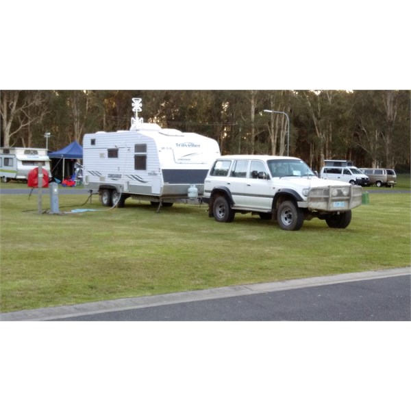

Yes i have to take the van over the inspection pits then they will update the rego papers i am in Canberra and in Canberra you get ripped off for everything We have the highest rego cost in Australia. $505. to reg my 22 ft van.
I had my 1994 80 series upgraded from the 2500kg to 3.1 towing a few years back cost $1000.00 all that was needed was heavy duty tow bar

Follow Up By: Outback kid - Wednesday, Apr 05, 2017 at 07:47
my rig Greg what do you see wrong with it

For those who doubt the 80 series I have been one of a very few who have towed a 3 tone van across the ferry at the Daintree and continued up to cape tribulation was a scary drive because the road is very steep and very narrow. On the way out left early in the morning before ferry started so to avoid meeting any traffic as this would have proved to be problem on the narrow road. I would not do it again.
the 80 series performed faultlessly.
I have also done the climb from Gloucester to Nowendoc and on to Walcha this is also a very steep climb. Cruising across the Nullarbore was great and returning 16.5 liters per hundred is better than a lot of the modern vehicles including the 4 cylinder ones
