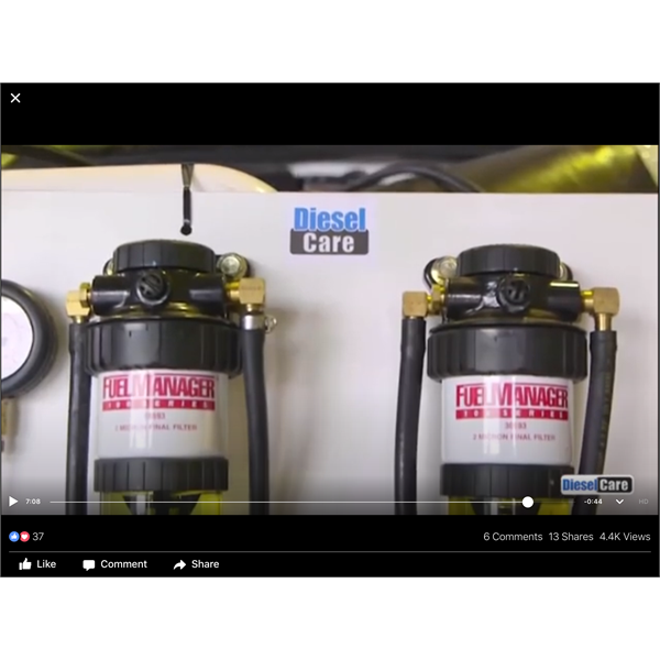

I had one of these Fuel Manager kits fitted to my Landcruiser ute. There are kits for most 4WDs, and think they're about $400 fitted.
Fitted as a primary filter, they give some early warning, though combined with a Water Watch unit would be the ultimate solution. Far cheaper than common rail overhaul.

thanks Bob, Deisel care in Toowoomba was recommended to me.I will be having a chat to Toyota too as have the prado booked in for a service this week.

I have a filter for Diesel Care fitted, and agree with Bob Y regarding they are cheaper than repairing a common rail motor.

Reply By: Sigmund - Thursday, Apr 20, 2017 at 09:44
Have read one horror story of dirt trashing injectors so I decided it was worth fitting a prefilter and went to my local 4WD specialist - long established and well respected crowd. I was prepared to stump up the $500 or so needed to supply and fit.
The guy I spoke with drives outback himself, and his advice was that it wasn't needed as long as you keep an eye on the warning light and just drain the bowl and whack a new filter in as soon as it comes on.
AnswerID: 610368
Reply By: pop2jocem - Thursday, Apr 20, 2017 at 13:06
Personally I reckon the addition of an extra filter or better still a water trap is a good idea whether a new CRD or even the old school mechanical fuel injection equipment.
Considering the cost of repairs and the much higher pressures and lower tolerances for anything but clean diesel, particularly important with CRD.
Has anyone considered fitting a differential pressure gauge or warning sensor to detect pressure drop across a primary filter? Water sensors obviously warn if there is any present but plain old dirt plugging a filter would only be noticed when the CRD pump is unable to generate the required pressure. I'm pretty sure the ECU will throw up a fault but I also know high pressure pumps don't like being starved of fluid for their intake side. Cavitation can damage their internals.
Pop
AnswerID: 610372
