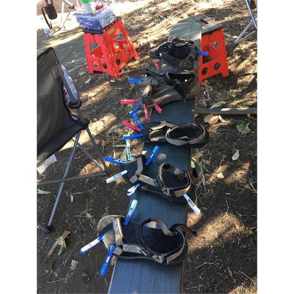

Some years ago I posted about always carrying "Shoo Goo" as it has so many cute uses around camp.
On our recent Gibb River trip we were going for a walk up Tunnel crk the next day so I dragged out shoe goo
and touched up the soles of my water walking sandals and with a few minutes my friends produced another 4 pairs needing a fix !
I was going to say that everybody should carry their own favourites as I quickly ran out.

Interesting use for the clothes pegs. Shoo Goo is new to me. I will investigate. Kwik Grip has always been my preference for shoes.

Yes , shoo goo also has filing properties you can get it in either black or clear.
I have even re-built a ripped off tyre lug in the bush with it and it lasted more than a 1000km till I got home.
I use mine on trailer plugs ok.
FollowupID: 884252

Bet Anne didn't do any washing that day, had on pegs. As for tips l cut up a thong to make a hinge when one broke on the camper, worst part was l had to wear boots for the rest of the trip.
Murray

Next time I need a hinge can I use your other thong as ones not much good to you !
