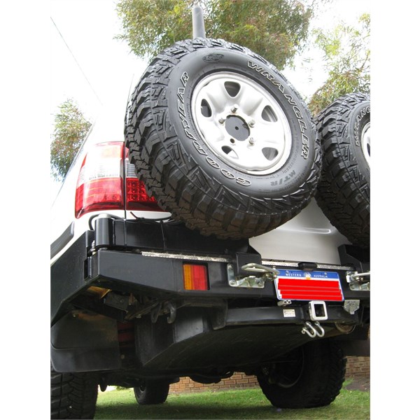

Everyone's got opinions and favourites re tyres based on experiences and where they go or have been.
Maybe try a different angle. I have a number of sets of tyres but my tyres of choice, for cross country 4Wding, are Goodyear Wrangler MTRs. Why?
Because I get a repair or replacement warranty for 4 years and it works.
If you get a puncture and it can't be legally repaired i.e. in sidewall, they replace the tyre pro rata plus fitting and balancing - No Arguements.
I have had them for about 6 years and so far have received over $4,000 in benefit from Goodyear and I still have six almost new tyres on my vehicle.
Are they any good you may ask? Yes with thicker sidewalls and Kevlar belting they are far more resist to punctures than my other sets being Mud KO's and AT KM2s. I save the BFGs for regular off roading etc and use the Wranglers for cross country work. On a recent trip doing cross country work in mulga country and I was lead vehicle, I got two slow leaks whereas those following in my wheel tracks wrecked tyres or got up to three punctures each.
Wranglers are excellent value for money - they are a robust tyre and the insurance makes them top of the heap in my opinion.
PS. You can only get the warranty from a Beaurepaires store.
es
AnswerID: 618427
Follow Up By: Theo D - Friday, Apr 20, 2018 at 17:33
Can back this post up!
People give Good Years a bad name. They are tough as and offer good mileage.
The best of all the Wrangler models are the Duratrac's - hands down. They are a very aggressive AT much like a Mickey Thompson. I got 75K out of a set on an old work vehicle and they spent 80% of their time on dirt. Never an issue.
The Silent Armour models.... stay a mile away. They offer excellent mileage but are horrible off the blacktop. I mean really horrible!!!!!
FollowupID: 890423
Follow Up By: Bob Y. - Qld - Friday, Apr 20, 2018 at 17:40
I had Wrangler MT's on a Landcruiser work ute some years back. Only tyres I've ever got >50K kms from. Good tyre in the bush too!
FollowupID: 890424
