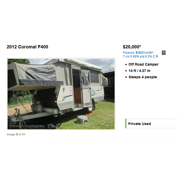

Follow Up By: Nomadic Navara - Thursday, Sep 27, 2018 at 23:21
The trailer the OP has is actually a camper trailer and not a caravan. The picture comes from 2012 Coromal F400
