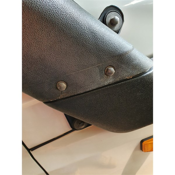

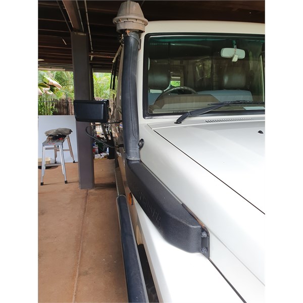

Hi All
My Troopy snorkel has just about had it. Toyota want close to $500 for the bottom and middle pieces.
ARB want $600 for a Safari one, apparently some drilling is required, not so keen on drilling my Truck. They will fit it for me for only $400 LOL! Not worried about the "complexity" of fitting it, just don't see why after market suppliers couldn't make it work using existing mounts.
Interested to hear what other people are using and their experiences.

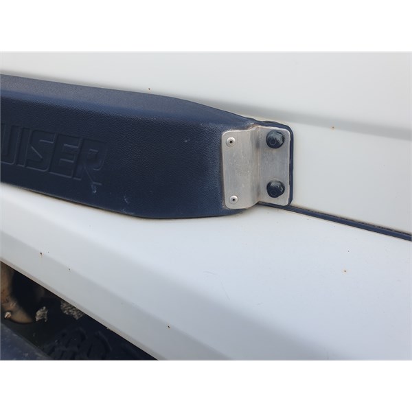

Reinforced mine when it cracked about 9 years ago still good today. Used a small piece of plate on the inside where the riverts are.

Good work! I never thought of that.
Well I've ordered a new one now. I got 15 years out of the first one, so who knows if I'll be alive in another 15 to repair the next one :-)

I did pretty much the same Harry.
Seems to be working OK.
Those OEM snorkels of Toyota must have been made in China.
