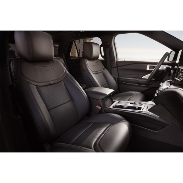

Heidegirl, the Huracan adaptors are just that, adaptors that allow Ford or Holden seats to be used in your Toyota. I looked into it for my Patrol but the seats sit too high for me. I found the best Ford seat was the Explorer ones, no high bolsters on the sides, easier getting in and out and also storage under the drivers seat, bases are ADR approved as are seats, good luck. Huracan 75 series

HI,
thanks for your reply. They sure do look like nice seats, but the Hurican listing says the adaptors only fit from Ford BA - FGX. So I'm presuming these newer model seats won''t work?
I'll follow up with Hurican - where did you get yours from? Not seeing anything like this on ebay or gumtree

Heidegirl, I bought from Huracan direct. If you compare the pic of Explorer seats and XR6 seats, the Explorer ones are much easier to get in and out of. They use the same runners, so no problems fitting to the Huracan base.
