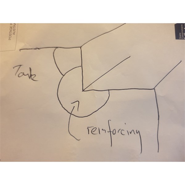

Murray I had issues but more around the structural integrity of a replacement main tank for my Patrol. They had not gusseted or reinforced top and bottom edges causing them to crack and weep. More disappointing was ARB, 's unwillingness to stand by their product (supplied and fitted by them in Bayswater). They just supply and fit. "You'd need to take it up with the manufacturer" they said. Buyer beware!

Follow Up By: MickO - Thursday, May 20, 2021 at 07:38
Gents, "Buyer beware" is my comment not theirs so sorry for any confusion there. Tank was 18 months out of warrantee.
After much towing and froing and some robust conversation they offered to remove the tank at my expense and send it to Qld. Reinstal would also be at my expense and car off road for 2-3 weeks.
In frustration, I took the car to Brown Davis who pulled it out repaired and reinforced it with pakman plates for around $300 if memory serves me correctly.

Couldn't think of a better way to describe them John. They are a circular plate with a piece cut out o match the protruding edge of the tank. Reinforces the two pieces rather than rely on the weld alone. Resembles a pacman from the old video game.
Hope the highly detailed and skilled engineering drawing (NOT) gives you an idea.

Having a fuel tank with an internal step return like that will cause high stress right at that internal corner point. I am surprised the manufacturer doesn't know. The failure rate is probably low and then most of claims can be avoided/stalled anyway. Maybe they never looked at reinforcing plates on farm and earthmoving machinery.
